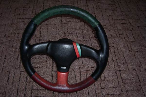

Re: Roland Garros by andi_kamachi
Taka kierownica??
