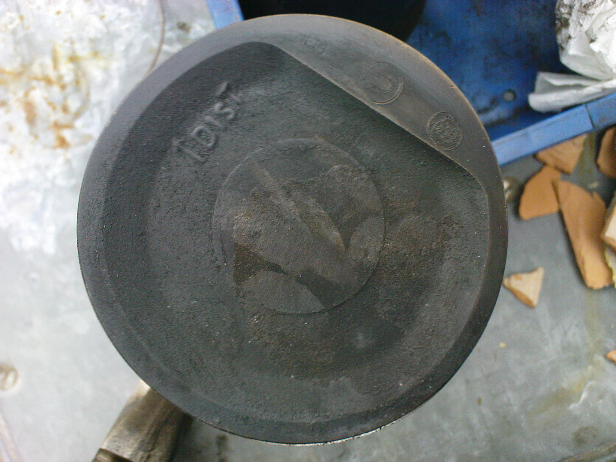

They are XU9JA(93kw) or XU9JAZ(88kw)pistons?
Re: piston XU9JA and XU9J1 and XU9JAZ
XU9JAZ
This is piston from XU9JA:

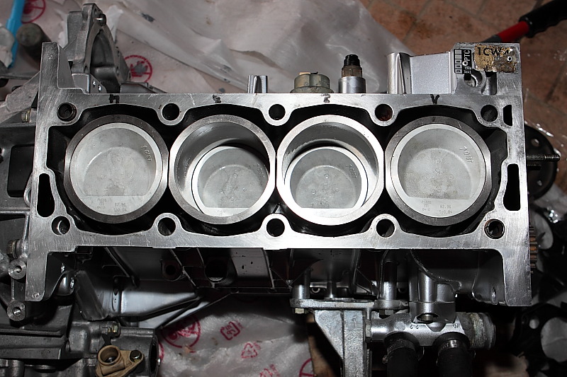

I found this photo with D6B (XU9JA)engine. What is correct?
Engine identification (D6b) is on the engine label
Ostatnio zmieniony 29 lis wt, 2011 2:17 pm przez Hroche, łącznie zmieniany 2 razy.

Tłoki z XU9JAZ są bardziej wklęsłe bo ten silnik mam mniejszy stopień sprężania. Te na foto u góry( w silniku) to na bank są tłoki z XU9JAZ, takie same mam u siebie :Y

Hroche pisze:I found this photo with D6B (XU9JA)engine. What is correct?
photo is from http://www.club205gti.fr/forum09/index.php
pawel
Posty: 1120
Post autor: pawel »
Hroche pisze:
On the photo You have piston XU9JAZ

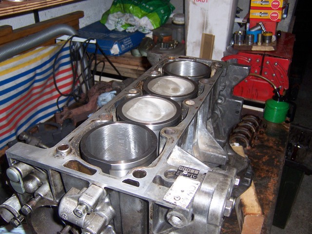

I have other photo with D6B engine and pistons are identical
Here:

Hmm... This is piston from XU9JA from Kaktus's gallery :o :
http://gti.peugeot205.pl/gallery/main.p ... temId=8859
EDIT: Kamkiler have pistons from XU9JAZ(DKZ): http://www.kamkiler.205.pl/
EDIT2: XU9JAZ(DKZ) have Compression Ratio 9.2:1 but XU9JA(D6B) have: 9.6:1 with the same cylinder head so pistons in XU9JAZ(DKZ) must be deeper
